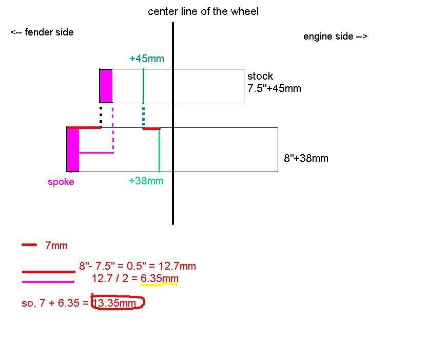

Message Depends on the spoke design.
Assuming this spoke is flat like the stock, stock front is 16x7.5"+45mm and the new front is 18x8"+38mm:
1) 38 - 45 = |-7| = 7mm,
the new wheel sticks out 8mm more, which in terms you have 8mm more clearance.
2) 8"- 7.5" = 0.5" = 12.7mm
12.7 / 2 = 6.35mm,
The new wheel is 6.35mm wider on inner and outter side.
3) 7 + 6.35 = 13.35mm
The new wheel has 13.35mm more clearance and sits 13.35mm furthur out.
Simple?
Erick
