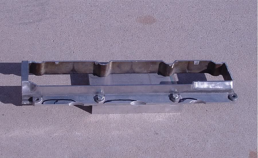

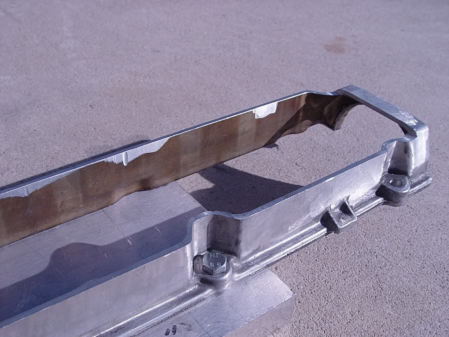

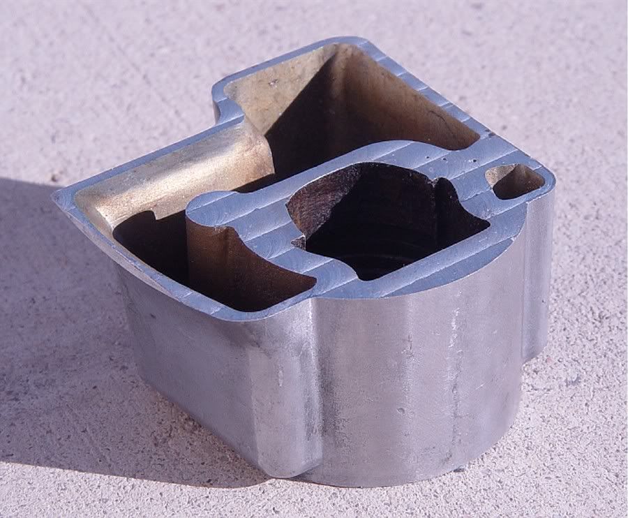

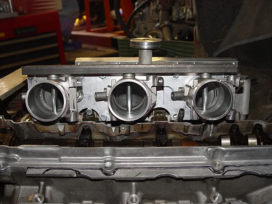

:Heavily modified cam covers. This was done to allow clearance for the TB's and plenums. Those towers looked goofy anyway. ;)

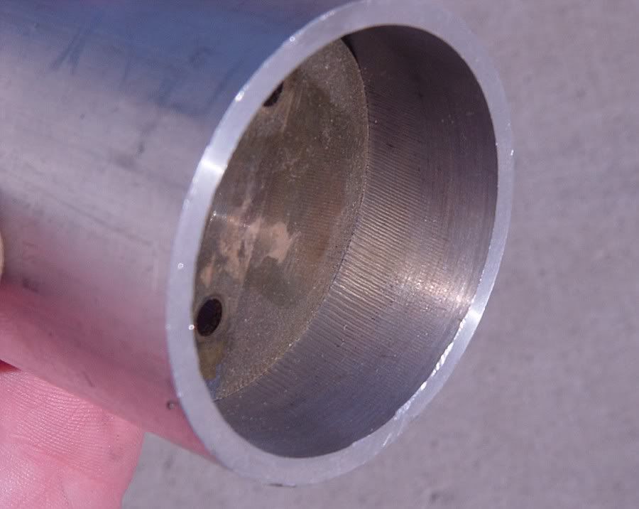

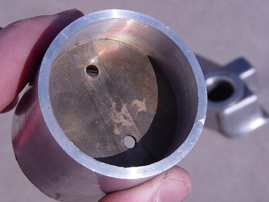

:The oil fill will be welded at the very front of the passanger intake cam cover to allow clearance for the TB's. Also my attempt at fabbing up a TB of my own, it's not finished yet. Anyone have any stock Z TB plates they want to donate?

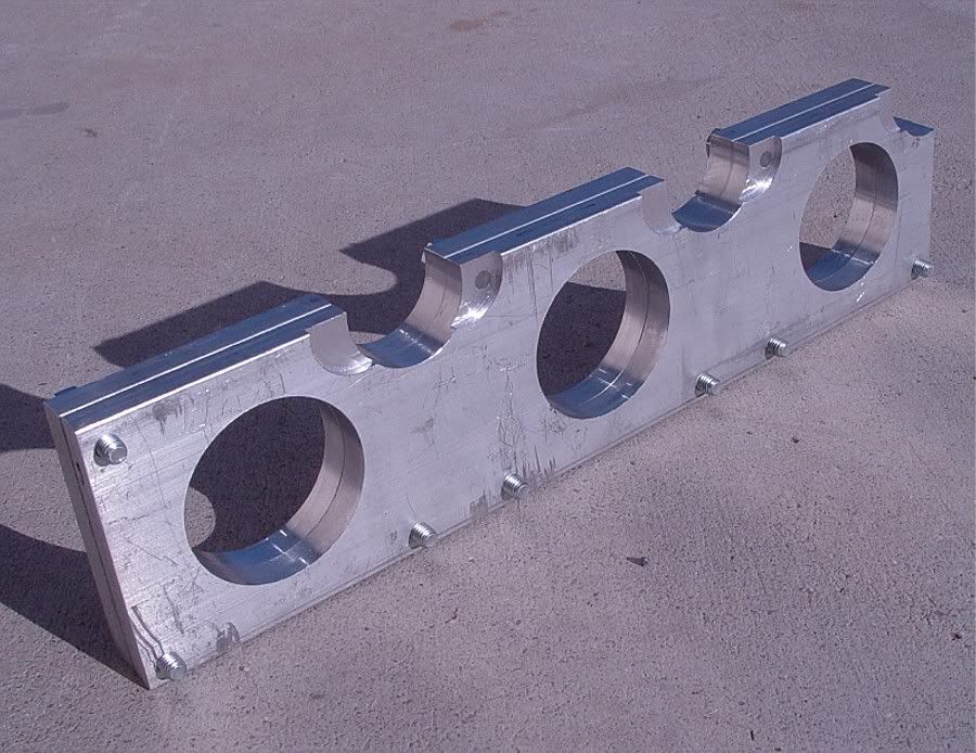

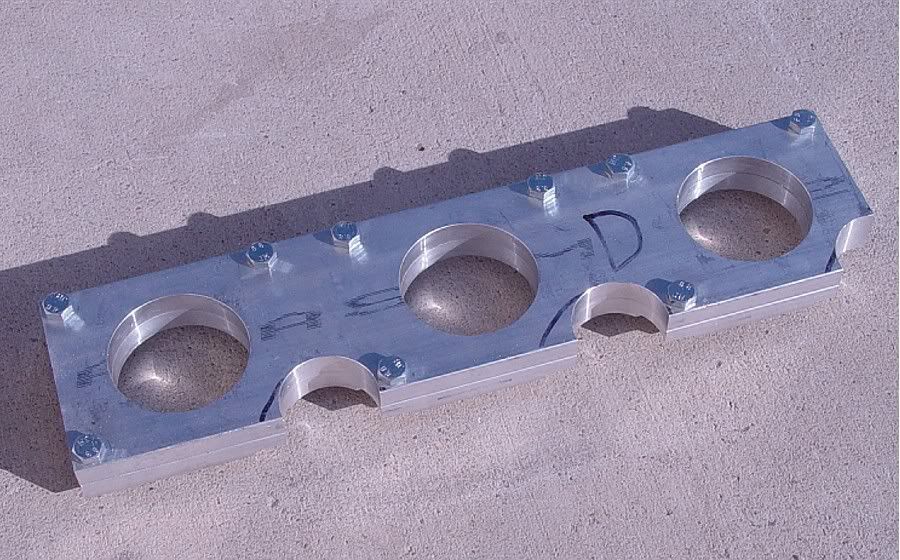

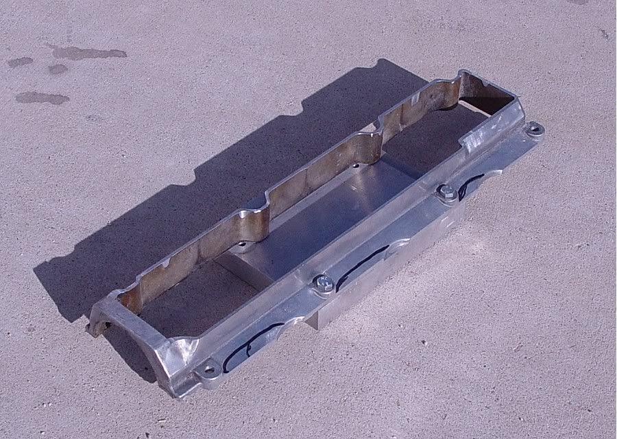

:Modified flanges to clear injector connectors.
:The extra reliefs are for the screws that hold the injector caps.

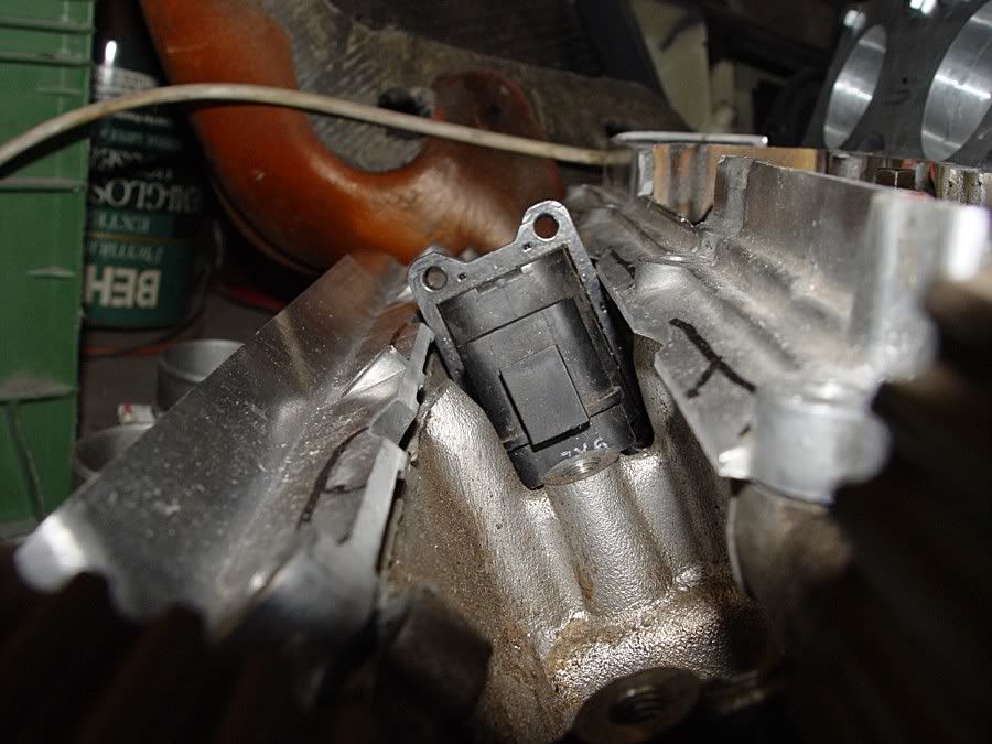

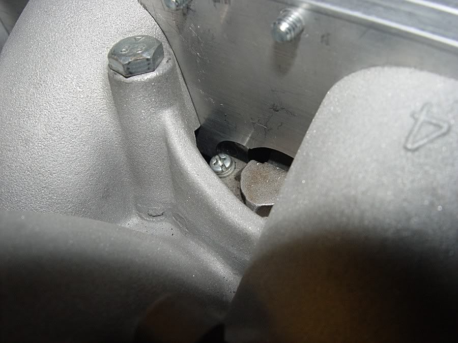

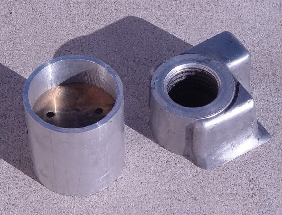

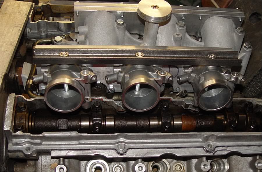

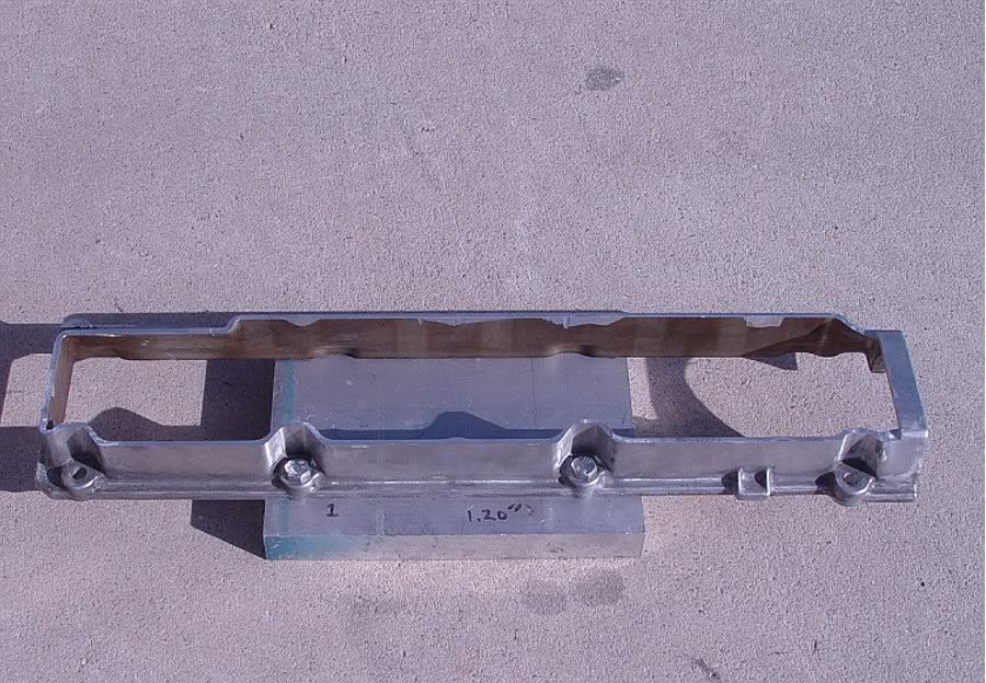

:Modified coil packs to allow clearance for plenums. It's easier than you might think.
:Shortened coil pack. I need to machine more off the cam covers (area marked). Notice the large chunk missing from the intake cam cover? Make sure you have a nice fixture to bolt your work to rather than being lazy and clamping it directly in the vise...I learned my lesson. Anyone have a spare passenger side intake cam cover?

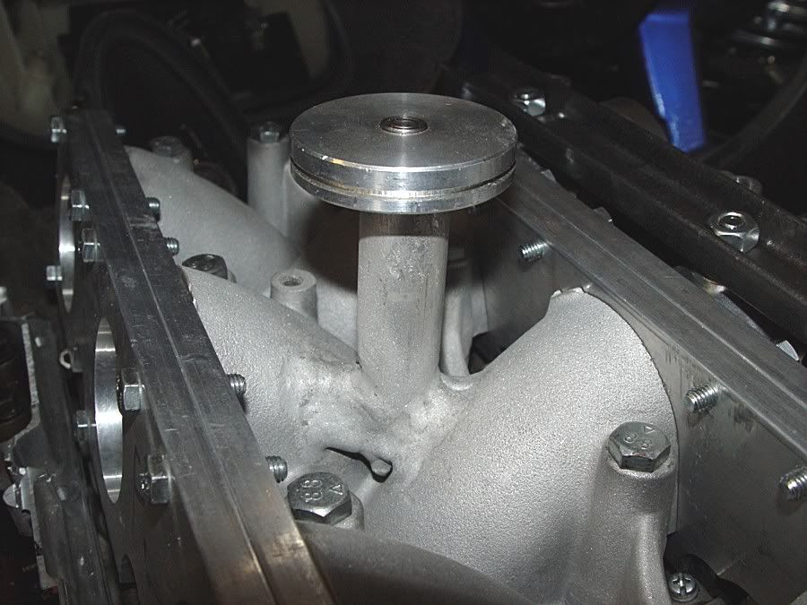

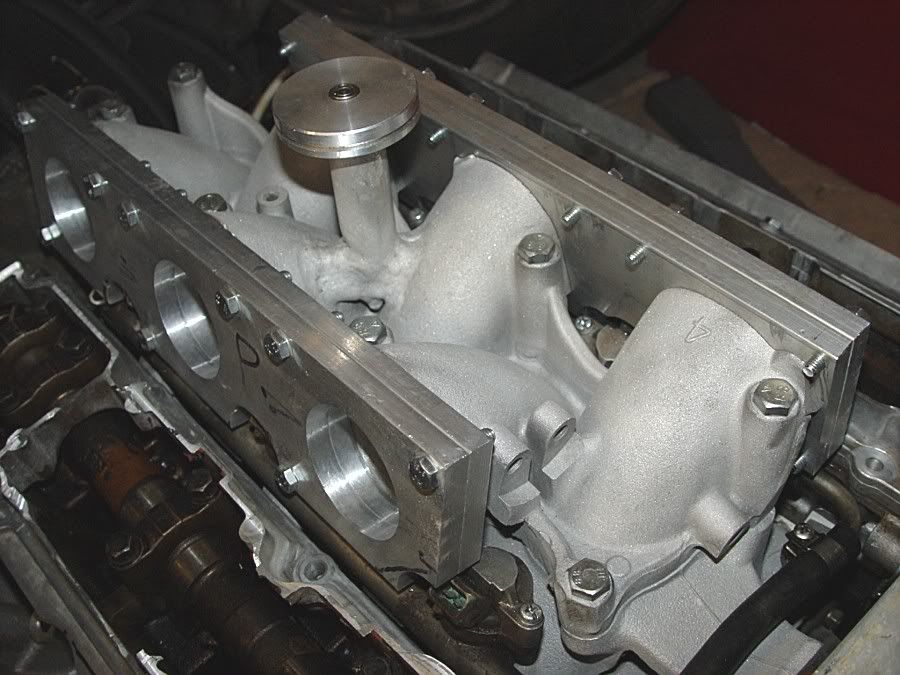

:Not the prettiest weld but it's not going anywhere, and I did it myself. The pully will sit ~1.5" lower when everything is said and done.
