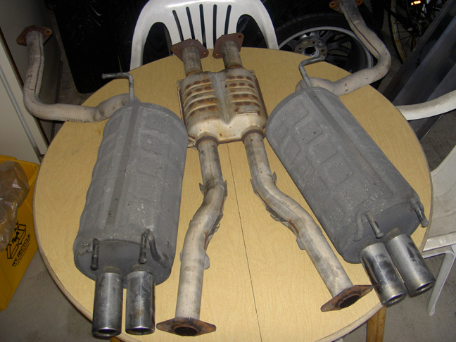

The 2+2 had round mufflers:

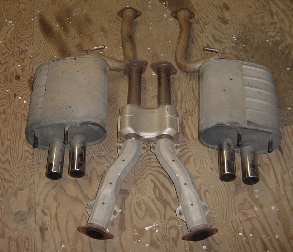

The 2 seaters had oval mufflers:

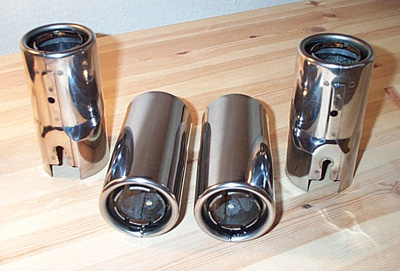

They all had chrome tips of the same diameter. They tips on the 2+2 are a bit shorter then the ones on the 2 seater to accommodate different muffler & bumper geometry.
These tips are from my '95 2+2, they interchange to any year.

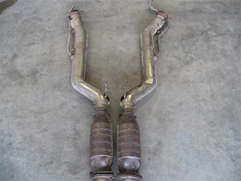

The only notable production/design changes to happen to the exhaust is:
A. The AIV feed pipes on the cats where removed in '93, this is a 90-92 set of cats.
B. In 1996 w. the addition of OBD2 the cats got a set of oxygen sensors placed in them down wind of all emissions equipment.

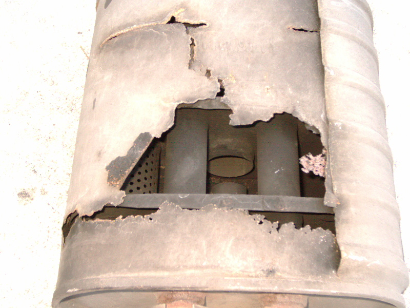

Finally here is a "rust away" shot of a stock 2 seater muffler:
