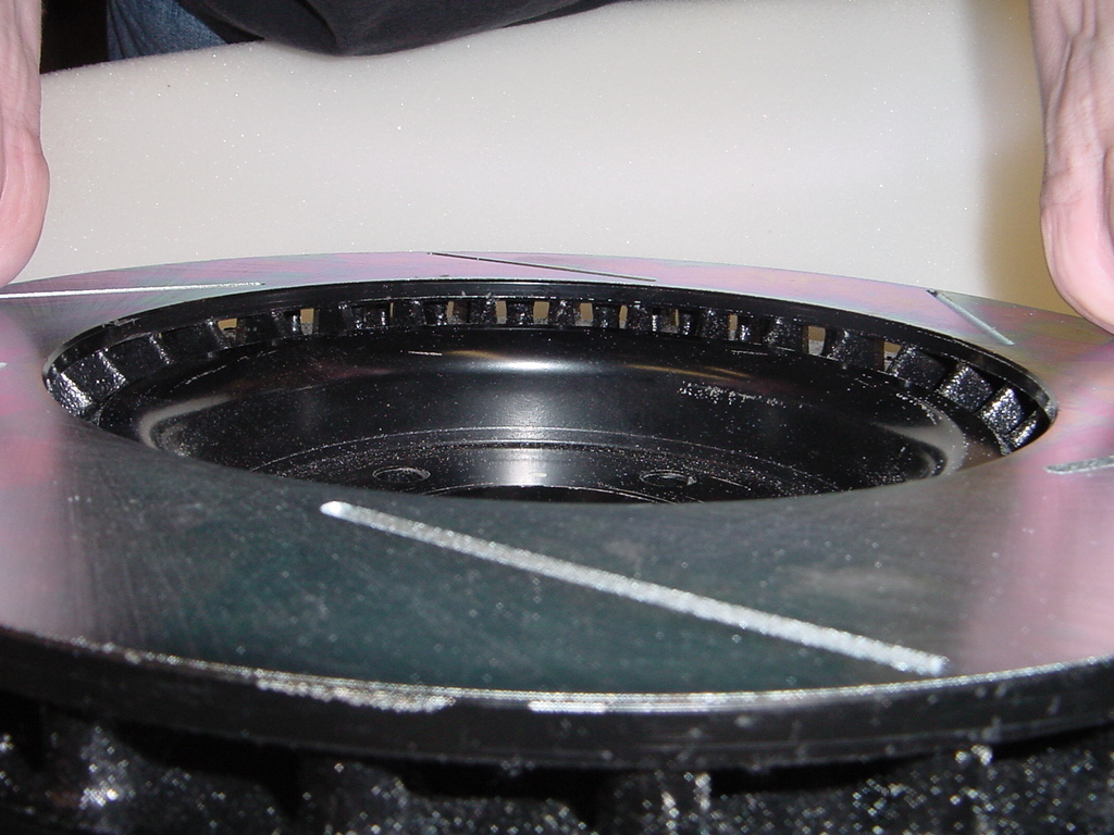

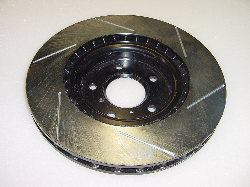

Message also have a limitation on how well they cool. The 350Z Track rotors have full depth vanes from the inside of the hub to the outside which is how you want rotors to cool.
