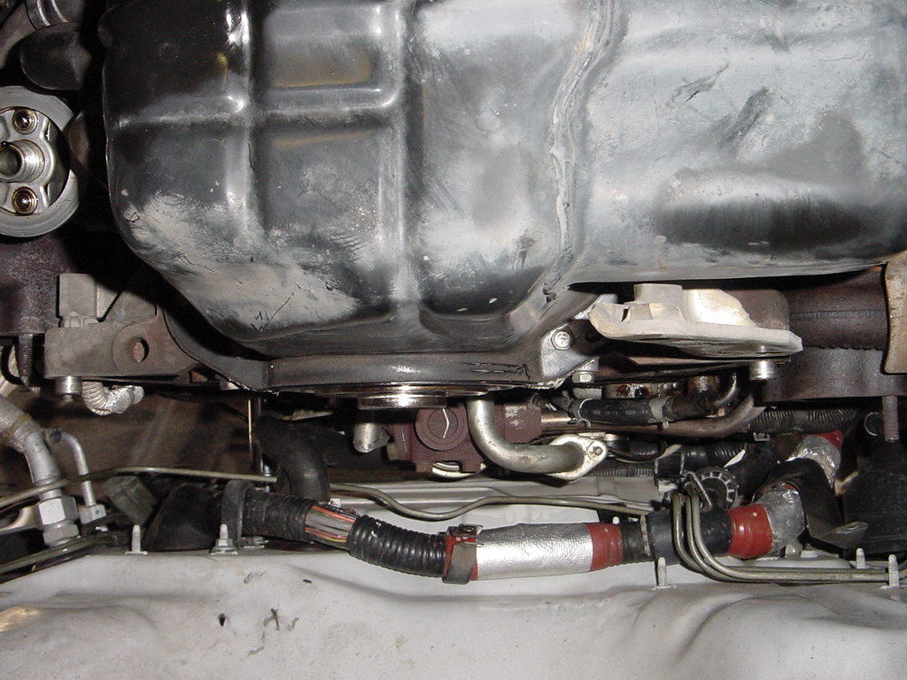

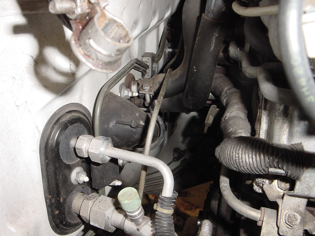

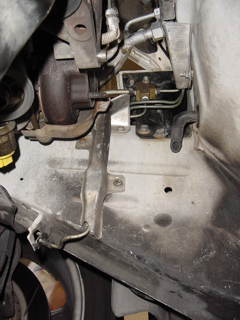

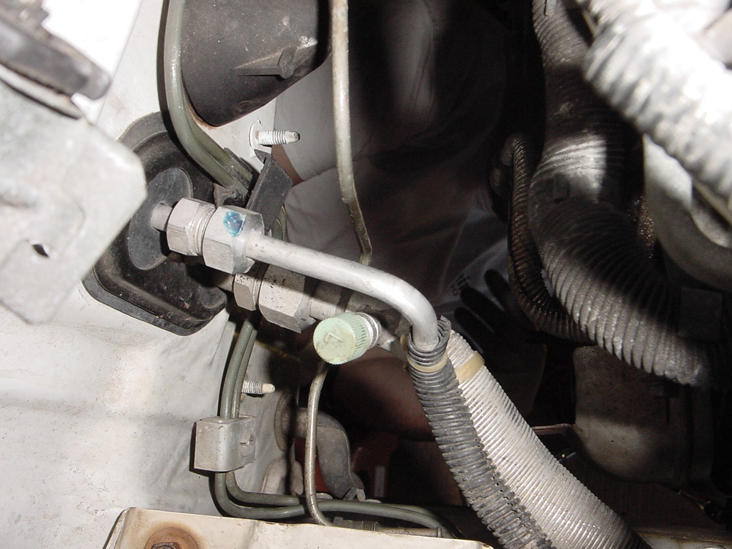

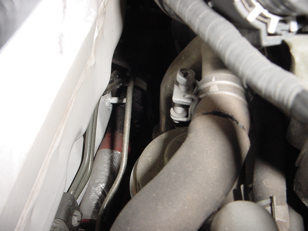

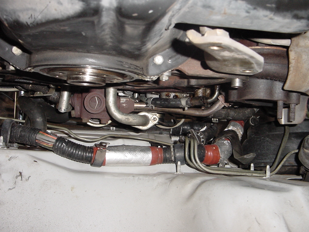

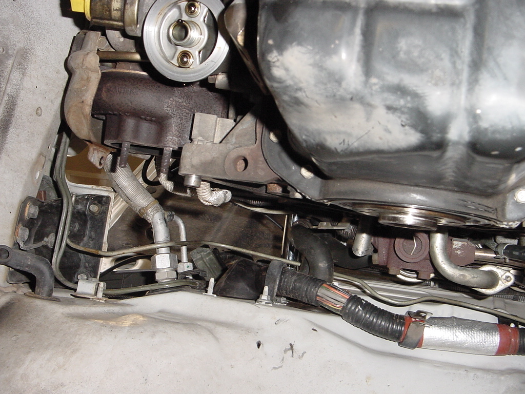

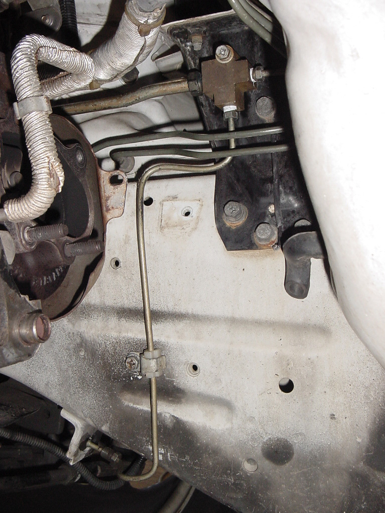

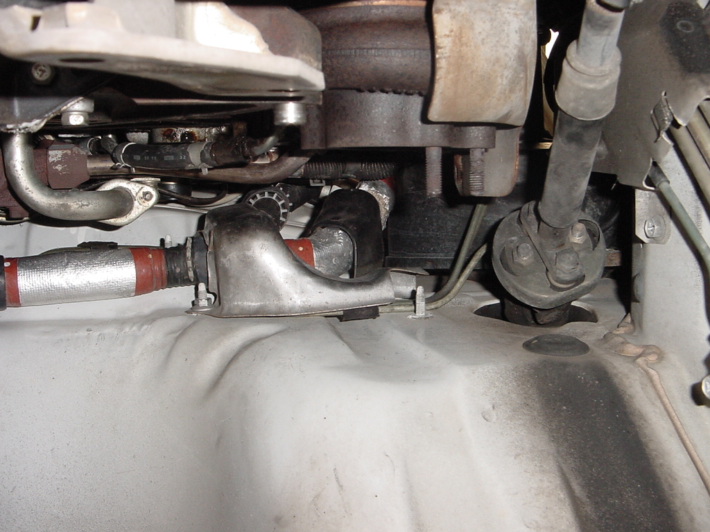

Message We got it behind all the heat sheilds & all the mounting clips all the way from the juntion to the Master cylinder. Then we ran the high bleed line from the inner fender to the junction.
Here are some pictures of the line routed (but not yet cliped in place) in some of them. The finally install is 100% secured in stock locations & behind the heat sheilds:
