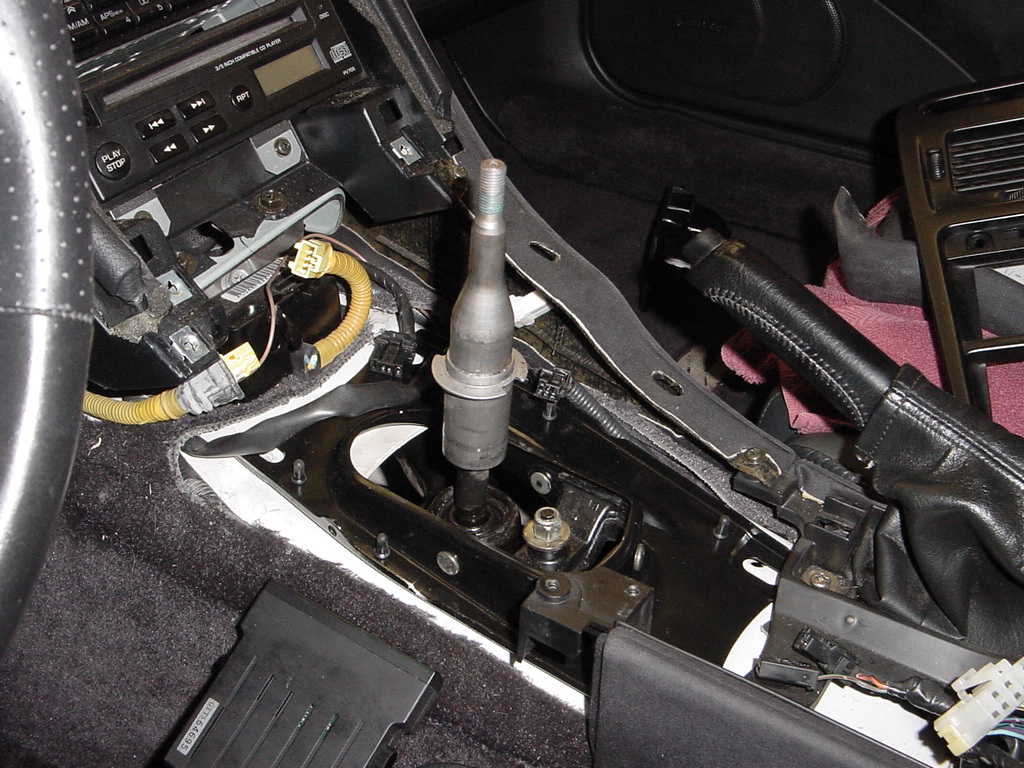

Spencer starts tearing the console apart:

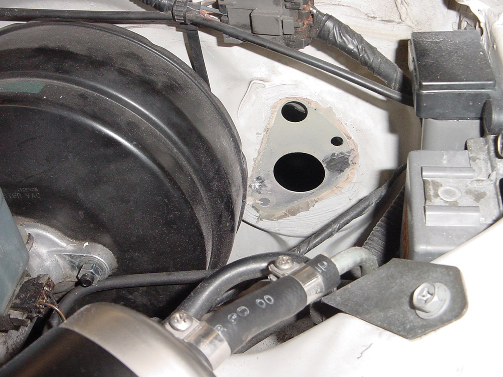

Making the opening for the clutch pedal is actually pretty simple. The car has a blank out w. 2 spot welds holding it in place. I just scored the edge of the paint around it to keep it from tearing and broke apart the spot welds:

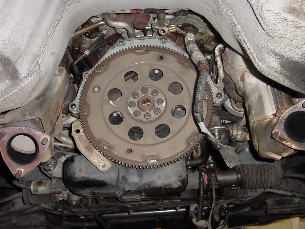

OEM TT flywheel back from the machine shop, they did a beautiful job resurfacing it for us:

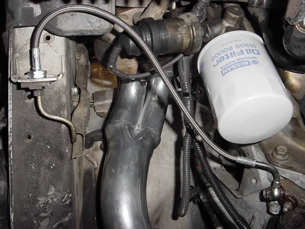

Fluid line junction w. heat shield:
Jeremy's frame rail already had the mount for the clutch line on it, we use the CZP braided line in place of a stock rubber line:

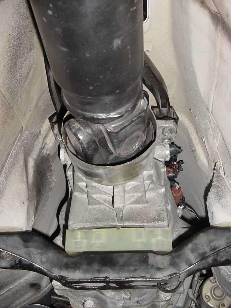

Driveshaft installed w. SPL solid Urethane transmission mount:
Ah thats better:

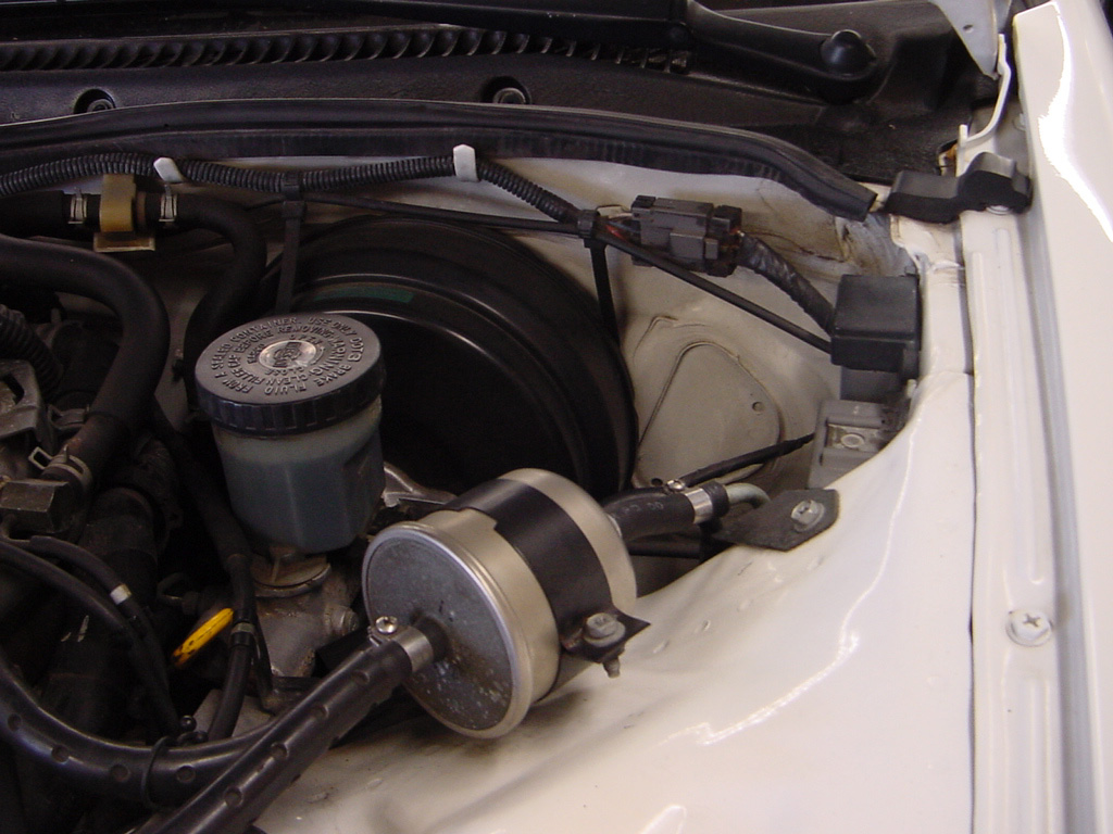

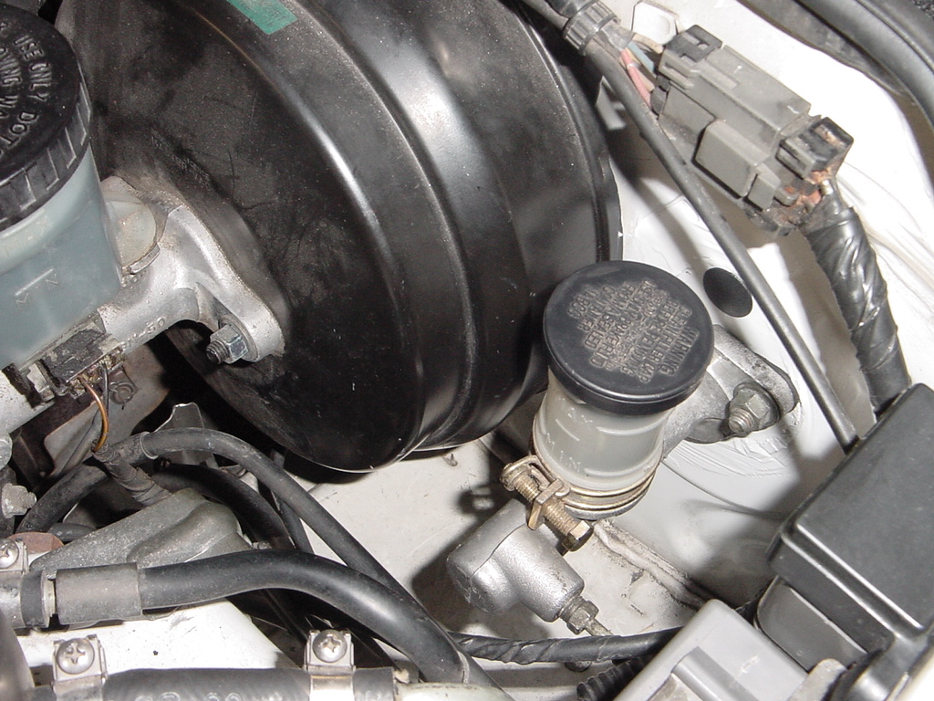

The clutch bleeder high point on the PS fender was very useful for getting the whole system bleed down:
