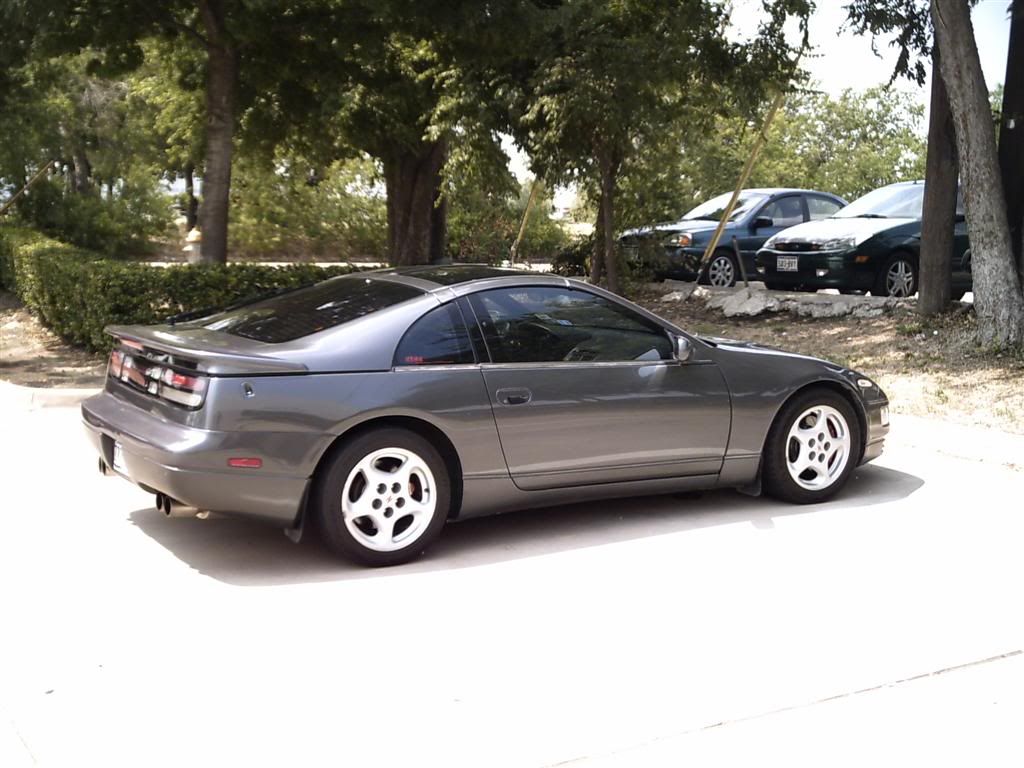

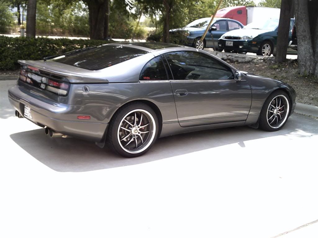

Message Got a good used set from a good friend of mine earlier this afternoon :-)

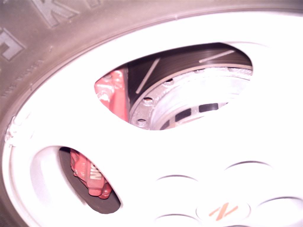

Before:
then after:
Just need some wider tires front and back, and clean up the blings :-)

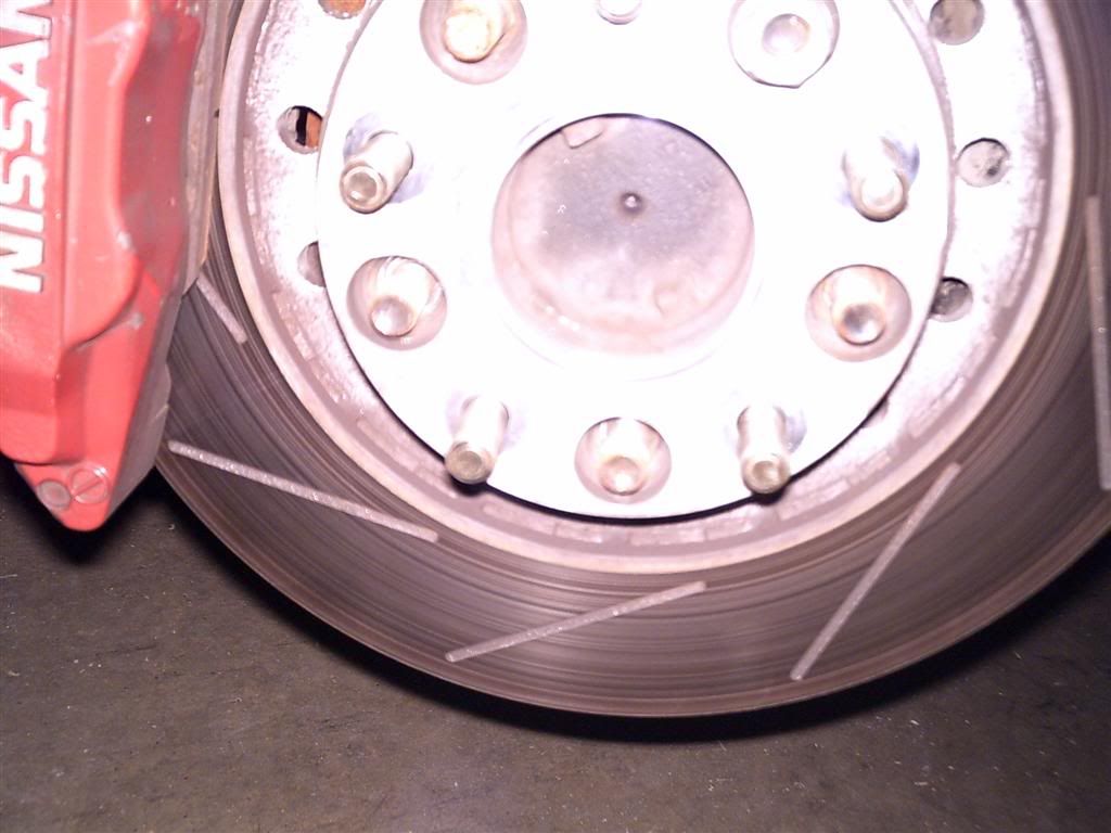

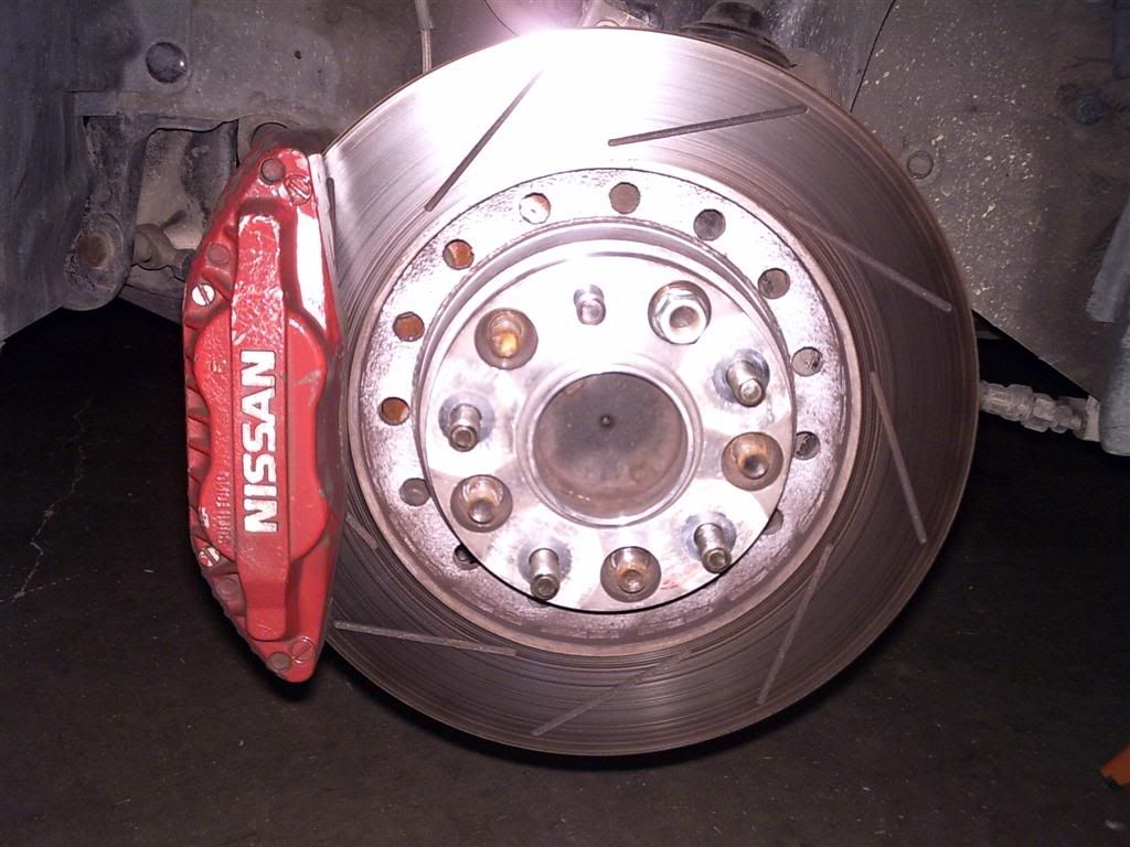

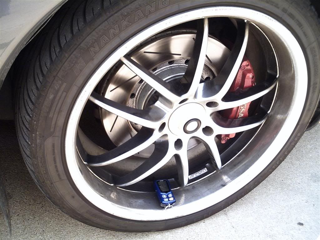

BTW, this is the 20mm thick wheel adaptor I used to clear the VR4 BBK under stock 16"s.
It's made the Kyo-ei in Japan. Bolt the adaptor on to the hub and secure with the supplied lug nuts to the factory wheel studs; then bolt the wheel onto the studs of the adaptor.
The stud holes are lug centric, which means that when tightening the supplied lug nuts, they will automatically center the adaptor to the hub. It is simple and easy, and there is no need to buy the expensive long studs and go thru the trouble getting the old studs off and new studs on.
and I also added hub centric rings to them.
