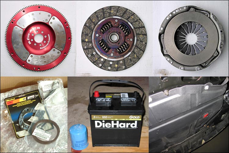

Message Out with the old:
In with the new:

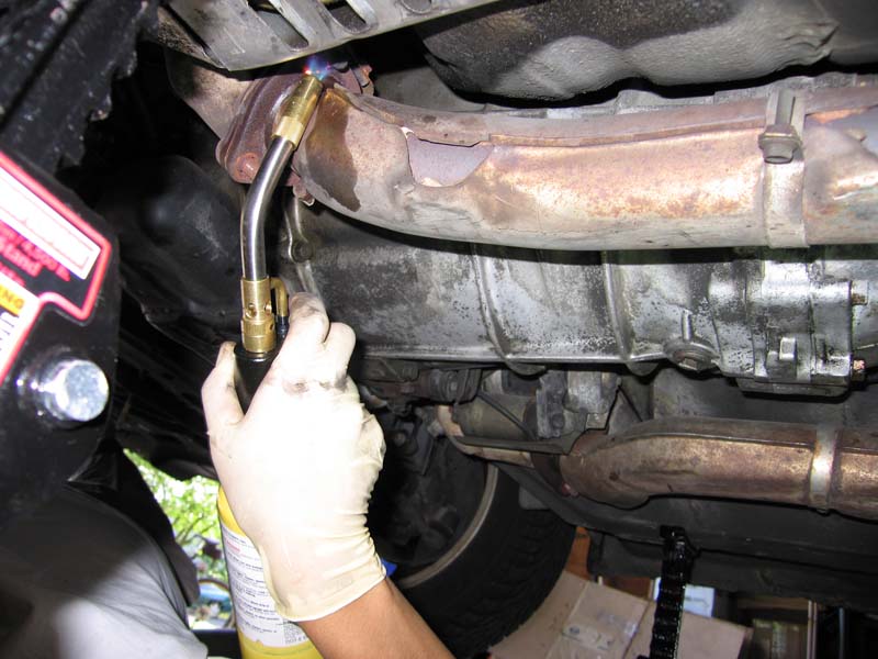

Fire is your friend, as we learned after two of these snapped:

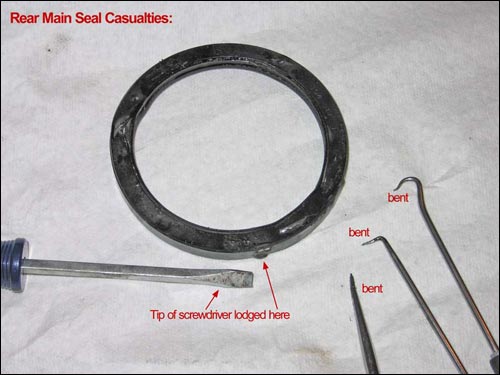

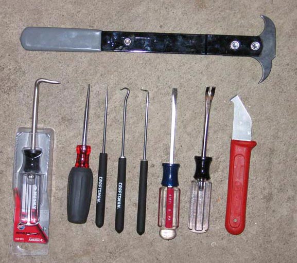

The total arsenal of tools I threw at it in all three rounds:
It was the seal puller that finally got it, once I figured out how to use it
right, but even then the seal put up a good fight.

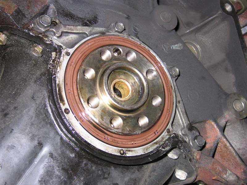

Checking to make sure...
This better be in right!
A beautiful thing:

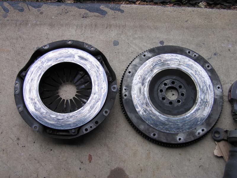

Yeah, it was time:

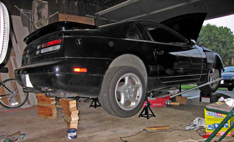

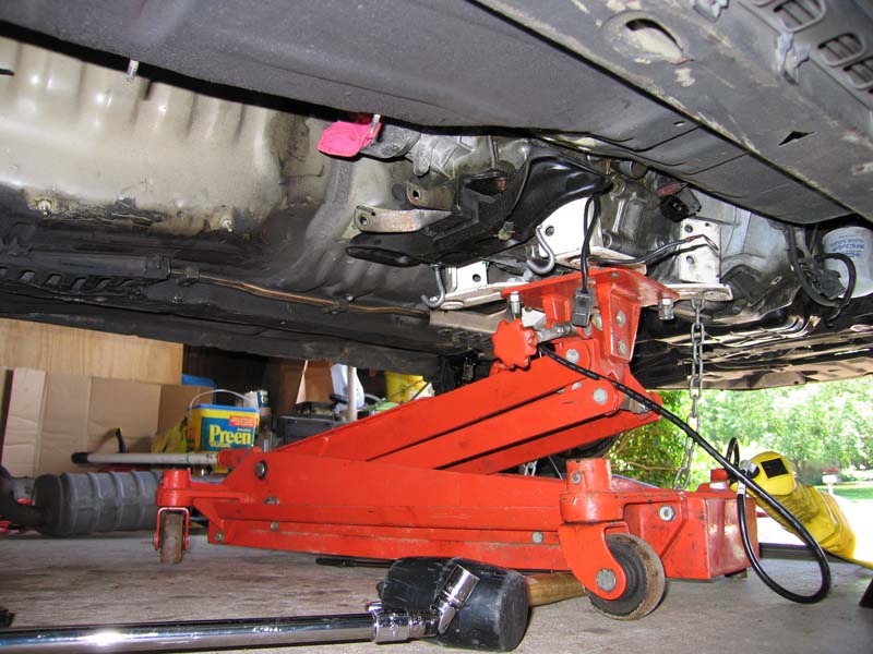

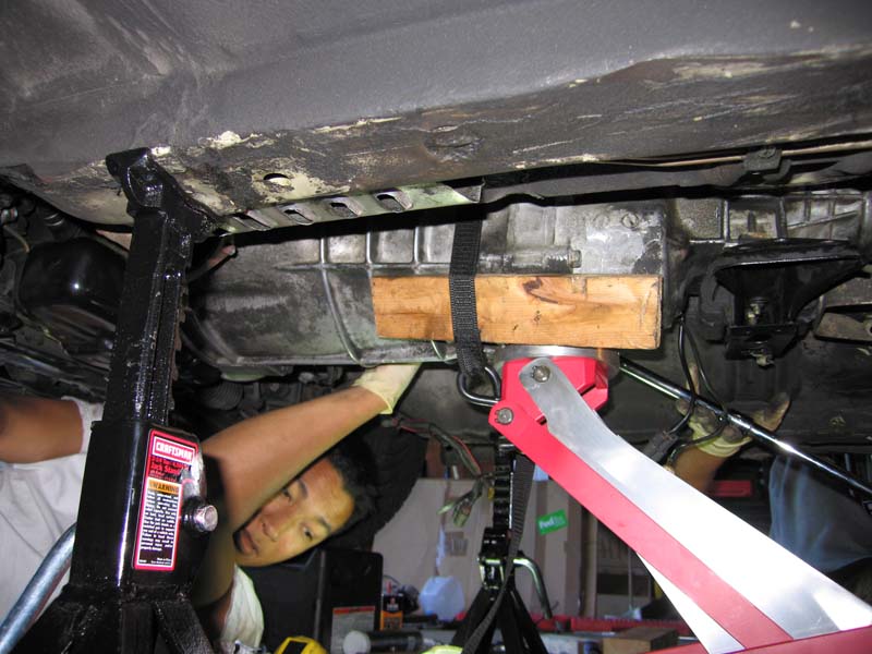

This rented beast sucked, and probably weighed more than the tranny
itself:
As you can see, it couldn't be left by itself - it had a slow leak. We finally
did away with it and resorted to the use of a regular jack and Wayne's
Jack Strap (TM):

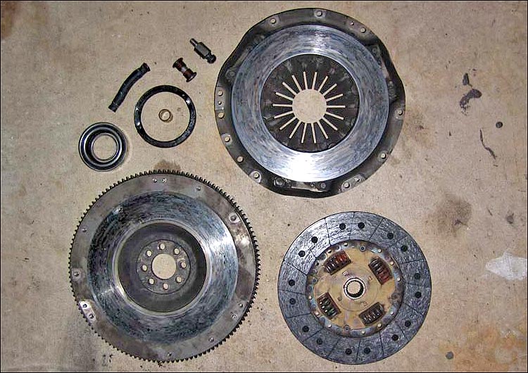

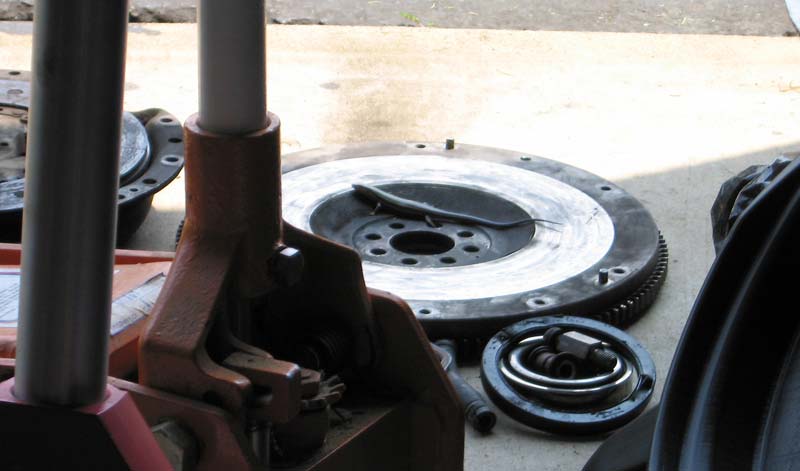

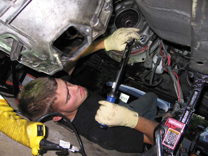

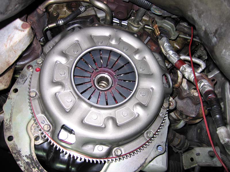

Cam, Wayne, and I each got to experience installing the clutch, as we
kept trying to figure out why the tranny wouldn't go in...
Come to find out when they say the alignment tool has to slide in and out
easily, they mean REALLY easily! We thought it was easy the
first two times, but apparently not enough! Finally got it so it was like a
hot knife through butter. "So a baby could pull it out!"

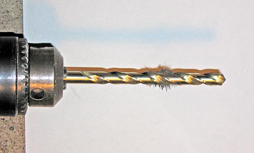

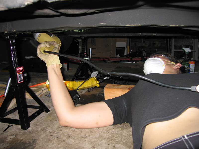

Drilling out broken-off studs is NO fun.
But this was pretty cool - anybody know why this happens? The metal
shavings all stood up in lines at the edges of the threads:
Not to mention finding their way into my bum... :-/

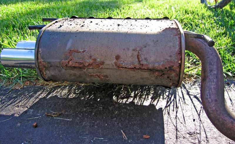

Looks like my next project may be replacing the exhaust...
