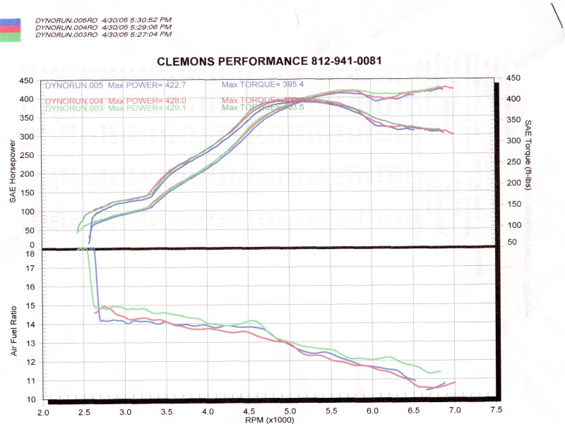

Subject Did you see the A/F from my dyno?
Posted by boileralum on May 12, 2005 at 2:23 PM
  This message has been viewed 146 times.
In Reply To Also... posted by ZEngineer on May 12, 2005 at 02:06 PM
Message Single pop charger, single pop JWT program, mods are pretty current in my profile. I added fuel on the SAFC-II between runs, which is why the HP went down.
