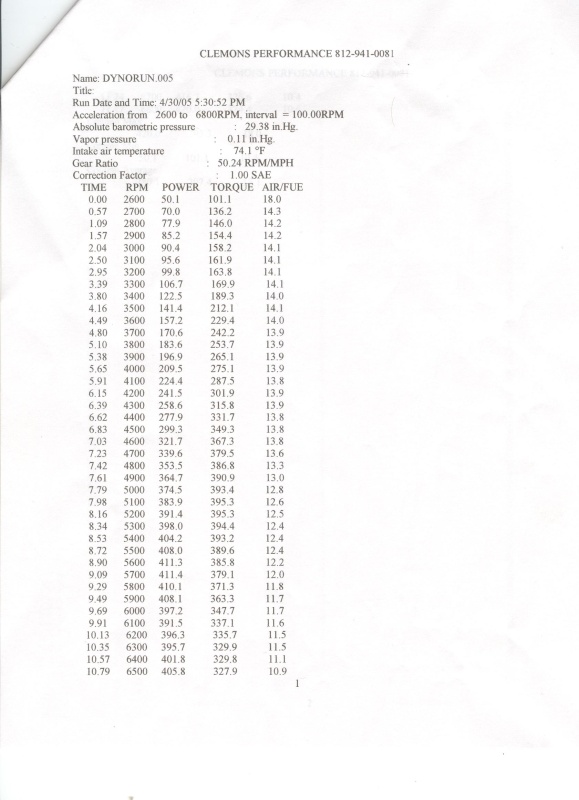

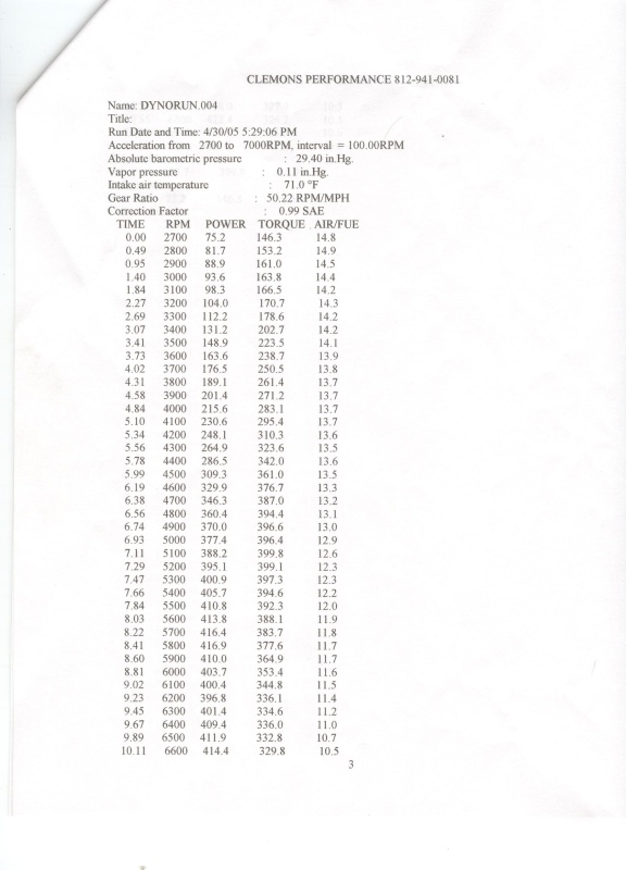

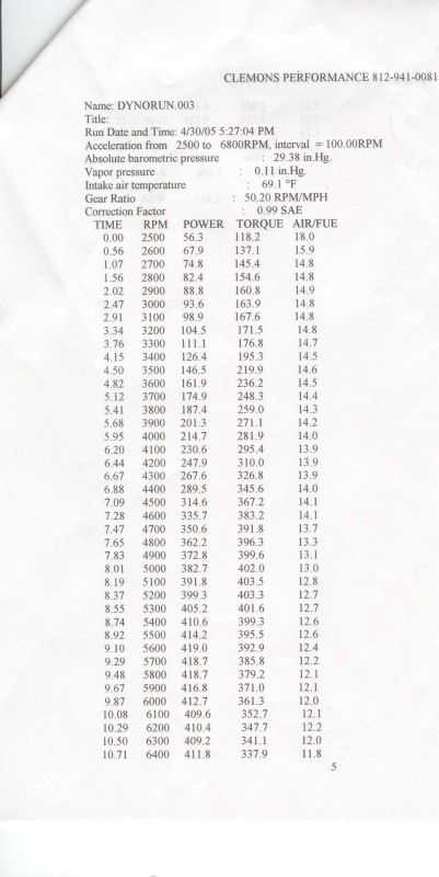

Message My AVC-R said 1.25 kg/cm^2 (17.78psi), but my EL Boost gauge read about 1.32 bar (19.14 psi) max pressure, so I'm not sure what the *real* pressure is at this point. The more pressing concern obviously is how lean the car is at the lower rpm range. I increased fuel after each run on the SACFII, but I still need to do more the get it safe. I was running on 109 octane leaded race gas today, but am lowering the boost for 93 octane until I get the car tuned. At any rate, on to the long-awaited data.
