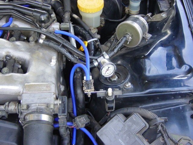

The 3/8" adapter is a little big for our 5/16" fuel lines, but with a little isoproyl alcohol (or WD-40) and some grunting, the lines will go on. Make sure you get some fuel injection hose clamps for 5/16" hose at the auto parts store for where you're going to splice in the adapter (the kind that are a solid band with the captive square nut and the screw). Also, put some teflon pipe tape on the gauge threads before screwing it into the adapter.
