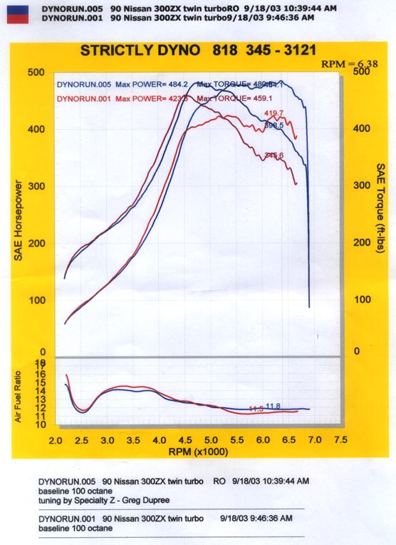

More info on tuning my car with pe1420 turbos

Wow... 61 rwhp just by changing the plugs
degradated
11:24:50 09/25/03
Actually I'm still running NA plugs with tighter gap
Thrash
11:32:10 09/25/03
Im sorry, WHY not get the right plugs? (n/m)
YugoBernie (NoVA)
11:41:20 09/25/03
We didn't have any while on the dyno
Thrash
11:50:11 09/25/03

Clean dyno sheet of the 005 and 008
Thrash
00:16:44 09/26/03
Sweet... thanks! That helps. (n/m)
degradated
01:15:35 09/26/03

Come to think of it, do you have the breakdown
degradated
13:36:49 09/25/03
I don't have that. I do know temp 001 was 80 degrees
Thrash
16:13:39 09/25/03
