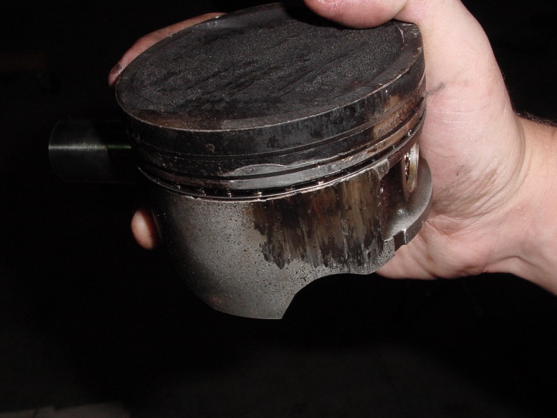

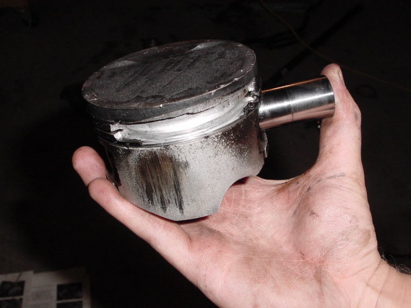

As you may remember (prolly not) i bought the car in less than perfect condition internally with 15 psi compression in #6 cylinder. Yanked the motor out and stripped it down and sent it off to be built. Returned a couple weeks later with new and improved pistons, rods, bearings, valves, and porting.
Here is the piston from before...

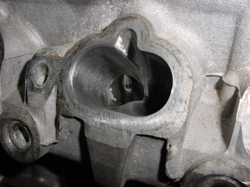

Some intake porting..

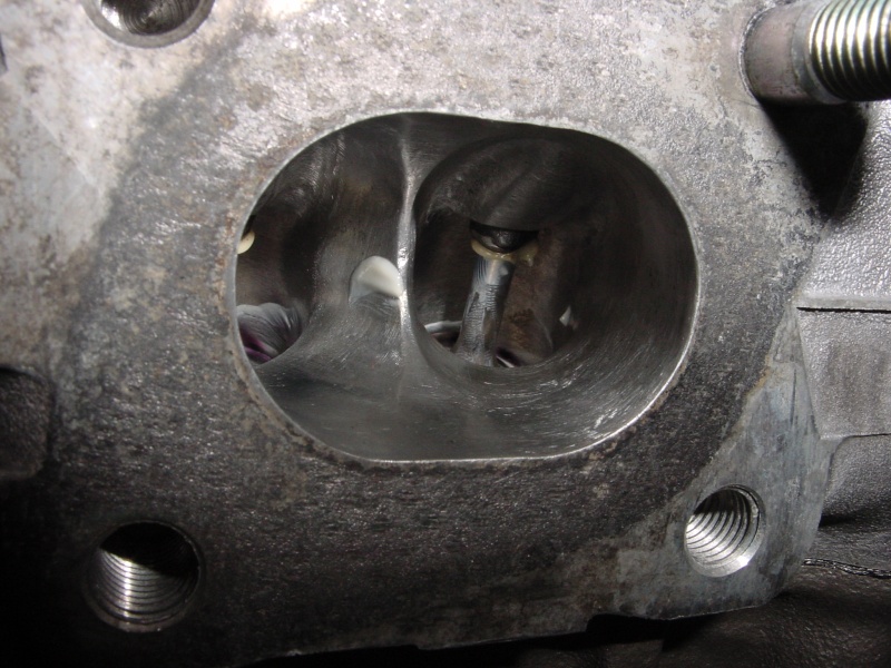

Exhaust porting, excuse the assembly lube.
