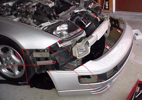

    4. Now to the tricky part. Remove the turn signal, held in by two philips head screws. Use a flashlight and look around in there. There are somewhere between 4 and 6 10mm bolts/nuts up there, which attach the panel to the front air dam. Three times I thought I was finished, only to have another one show up. Just keep taking them out, then wiggle the panel around, and eventually they'll all be found and the panel will come off. Here's a diagram of some of the bolts inside the front facia holding it to the frame:

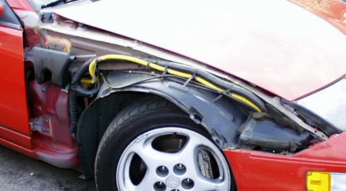

    Hope this helps somebody else! I was amazed that I could take off one of the biggest parts of the car in less than an hour... Luckily a fellow TTZer had a red parts car so I think I'll only be out a couple hundred bucks for the accident. Here's what it looks like with the panel removed:
